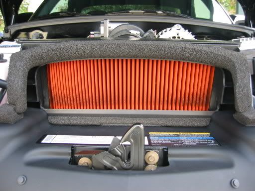

These are pictures before and after the modifications I made to the air intake. The air now has a direct feed from the opening above the grill bar and below the hood. All I did was remove the large plastic cover from the air box. This is an 05 so the foam does seal against the hood and keep the hot underhood air away from the air intake.
Before modifications:
After modifications:

Hey I can see where that would give you more cooler air, BUT leaves a direct access to a really bad rain storm, thus clogging the paper intake filter.
But then there are very few SSR out in the rain anyway...

I have the AirHog cotton filter, and yes it never goes out in the rain. It took all of 30 minutes to complete and completely free. If you look at your intake it is completely open under the shield/deflector anyway, so no different then stock.

If you are worried about rain hitting a paper filter. Get one like a K&N washable filter that isn't paper and doesnt sustain any damage from water.

The bigger question is water ingestion from rain or worse yet runing over a large puddle . I have counted at least three LS2 engines on the Corvette Forum that were toasted due to mass water ingestion and NO warranty in these cases!

Take a look at your stock air filter, look right under the shield and you will see it is a straight shot at the filter stock. All I did was to remove the shield which should allow a straight shot of air into the filter.

Thanks. I did the same thing, I found a Corvette filter that was the same and used it. What a difference in the underhood appeal with the filter right out in the open.

You said you removed the shield,
did you have to cut it away, or did you just partially disassemble it? It really looks good. :thumbs

Looks real nice but I have a few thoughts that some may want to consider.
In light on the dump truck dropping rocks out the tailgate thread I just read - here goes.
My luck would be that rock would miss the windshield and go through the gap below the hood/above the grille, punch straight through the filter and into the intake/engine. That would no doubt result in a really bad day and a bunch of wrecked parts like blower impellers, valves, pistons, cylinder liners, and cylinder heads.
Also, thanks to physics, the faster you go, the smaller the rock bumble bee or whatever needs to be to go through the filter. Something along the lines of twice the speed means 1/4 the mass for the same energy.
Just food for thought..

hdflstf - The aftermarket cotton filters have 2 metal screens and the material that it would have to penetrate before entering the intake track. It would then need to pass through the MAF - throttle body - ROCK CRUSHER (Supercharger) before entering the engine. I am not worried. You could always install a mesh screen over the filter for added protection.
Yaller Dog - I had to use a dremel tool with a cutting bit and a sanding wheels to remove and clean the area.

Fixed mine this way .....with K&N filter........but carry the cover with me ...so if needed I just pop it on....with new snap fasteners :)

I believe that the reason that GM puts that cover on is to prevent rain water from directly impinging onto the filter at highway speed.
The stock setup ensures that air-driven water can only get in through an opening that is BELOW the level of the filter. Then, when the air / water mix gets into that low opening, the air is sucked upward, but the water separates out because it is heavier - it can't "make the upward turn" fast enough.
The only way to get water into the filter with the stock setup is to submerge the front end or drive through enough water to drive a solid WAVE up into the opening. Nothing will stop the wave effectively.
Those LS2s that someone noticed on the net COULD be from cars that were victims of Hurricane Katrina. If someone attempts to start a car that was flooded without first checking to ensure no hydraulic lock, that's what happens.
