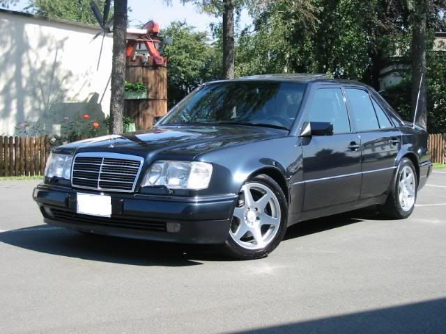

Why are you concerned by the low RPM?
For me the question is, what speed will I have if I'm at the max RPM for 6th gear.
"Evil-Twin" annoyed me last night on the highway, as it hit the RPM limiter at 263 km/h = 163 mph. ;-(
Looking forward to my SSR which should be over here in a few weeks.
Best regards,
Stefan
