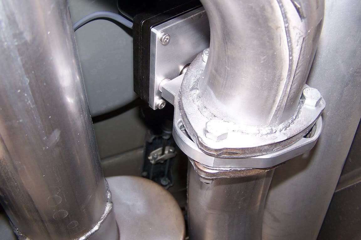

Here are some pics of the 3" electric exhaust cutout. Sorry they are so big, trying to learn the photobucket editing yet.

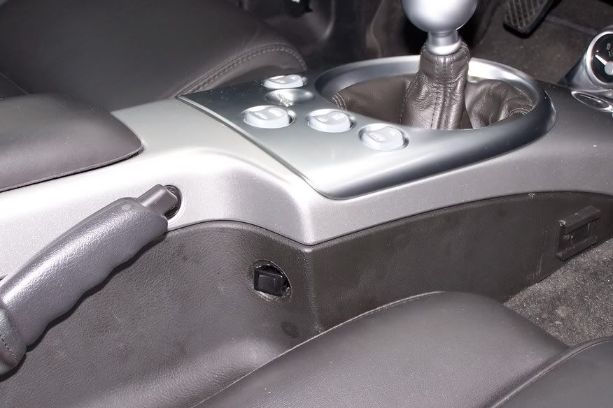

Yes its pretty noisy, but sure is fun to turn it on and off at the appropriate moments. It takes only 2 seconds to open or close. My picture of the fun switch didn't post for some reason, but I mounted it in the hole just in front of the emergency brake where there is a little knockout plug. Its a small 1/2x3/4 rocker switch and is all black so you cant see it unless you are looking for it..
THE FUN SWITCH FOR SURE :D

Cutout cost
The valve is made by DMH, they have a website and they are now sold by Summit Racing. They are about $180 bucks and includes the wiring and switch. They come in different sizes and have a four year warranty. Very simple for any muffler shop to install. My muffler shop charged me $250 and included the new 3" piping from the Cat back flange, Flanges for the cutout, the new Magnaflow muffler, the 3" side pipe, gaskets, chrome tip and labor. I did the simple design, wiring and switch mounting. Been running it about a week now and have no problems with check engine lite or any other problems.

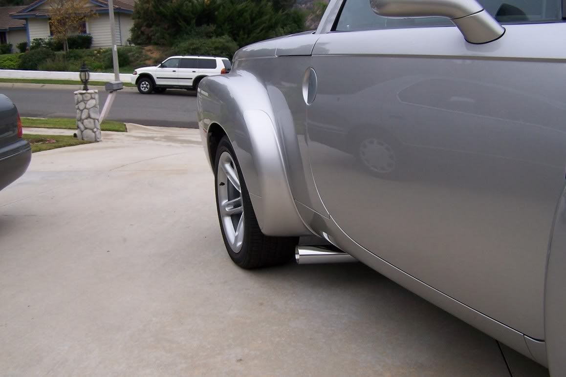

Looks like a very clean job. Does it exhaust on both sides of your SSR? Could you please explain a little more about what this setup does? Does it still utilize the rear system?

Discussion Starter #11 (Edited)
TIA-
The system with the electric exhaust valve closed is just like the normal exhaust. It takes the exhaust from the two headers aft of the CATS and merges into one 3" pipe into a muffler that has two 2-21/2" outlets that connect to the rear in the factory configuration. The cutout is in front to the muffler and Y's off the 3" pipe prior to going to the muffler. At the Y an electric soleniod and gate valve is plumbed into a single 3" pipe out the passenger side. When the valve is opened the exhaust flows out to the side with no muffler in the system. The valve is acuated by a switch mounted on the console near the emergency brake and can be open or closed anytime.
Here is a better look at the Y. Sorry Im goofing up on these pic posts.

The info and the pictures were great. I was just wondering if the three inchers went dual or just on one side. I see now, thanks a lot.
