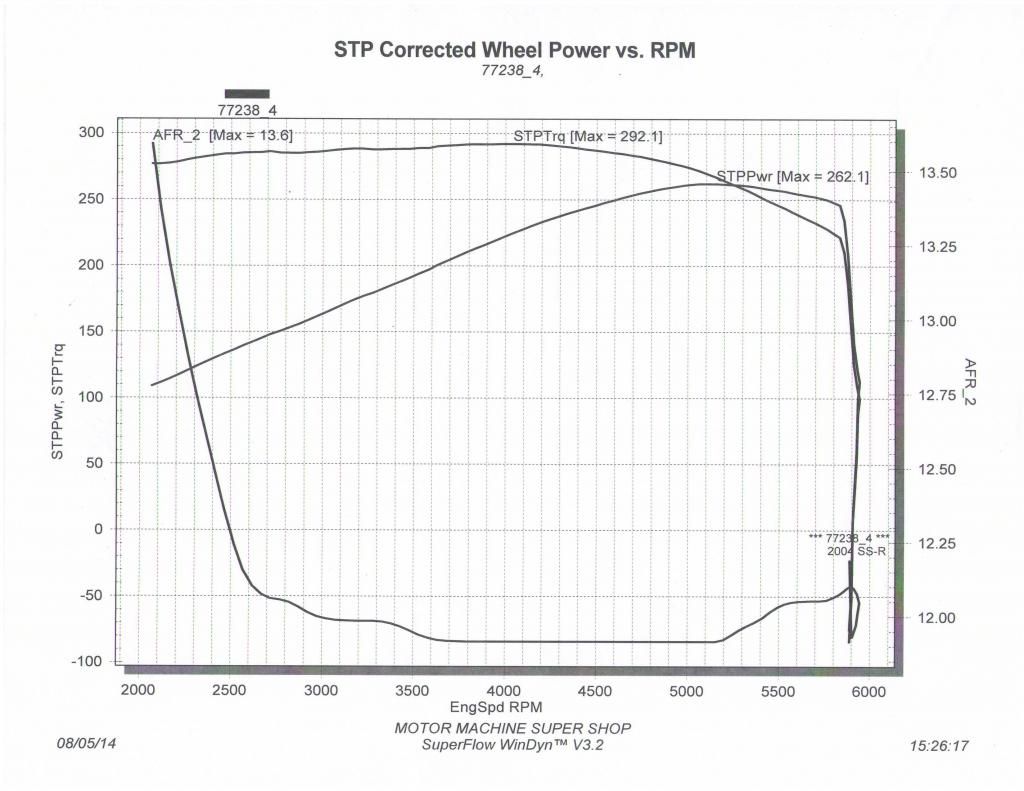

Start with a good tuner
Here's what I did.
We started with a few tweeks to the shifting and the basic air/fuel ratios with Mark's laptop and HP tuning software. With these changes nice improvement.
On to the dyno got up to about 125mph and 209 rear wheel horsepower when the speed limiter stopped us.
Bumped the limiter up to 155 and got 235 rwhp and 263.2 rw torque. 131.4 miles per hour
Mark tweeks a little more and the next pull is 262.1 rwhp,292.1 rw torque and 141.0 mph.
Mark's goal air/fuel ratio of about 12/1 and maximum safe timing advance.
The lower line on the graph reflects that ratio.
Great results:cool
